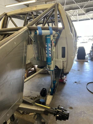

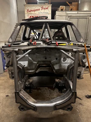

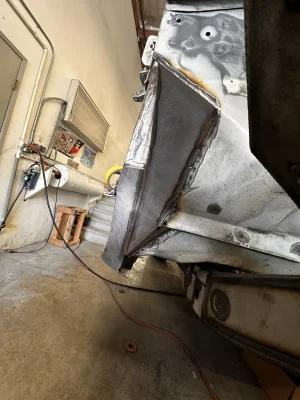

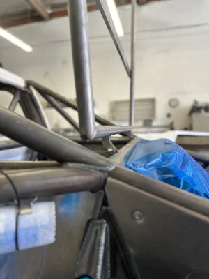

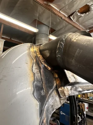

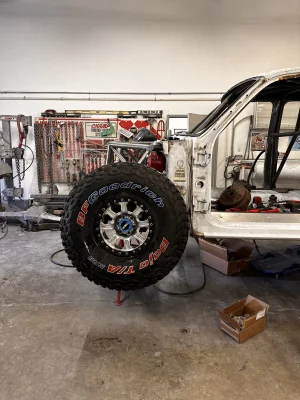

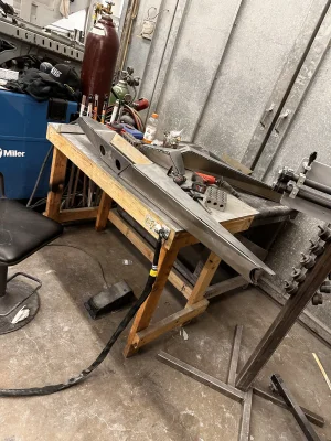

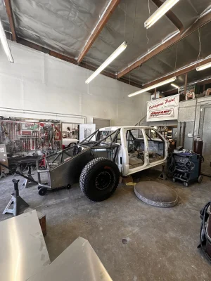

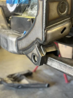

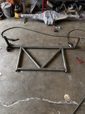

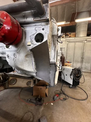

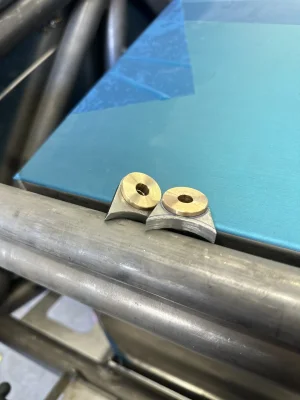

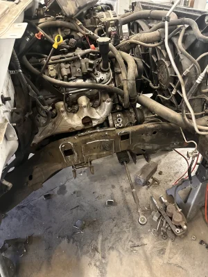

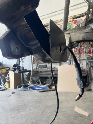

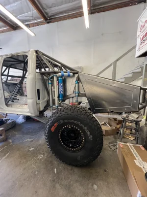

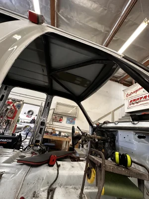

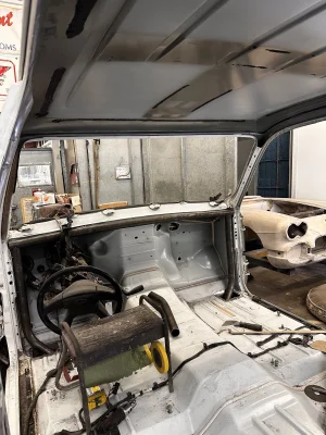

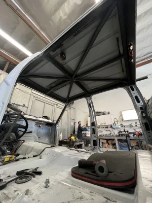

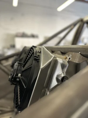

Hey guys another wicked build we have going on. Ill start from the beginning and post as i can. I dont wanna flood too hard but i will try.
Truck started life as a 2006 Silverado 1500 Crew cab!
Parts list;
Mazzulla Race kit
Howe TT Rack
Moruzzi 6.0 575 Special
Maximum TT TH400 Build
Paddle shifters
Blitz 3.5” housing w/2.5 hubs
MZ Spec backhalf(hand fitted to 06 chassis)

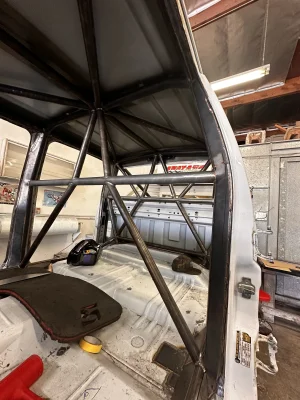

Full 2” cage
Armada luxo runner dash
PRP Alpha fronts
PRP bench rear
Fuel safe 60 gallon
Wilwood 6 piston fronts
Wilwood 4 piston rears
A ton of cool one off tricks and ideas that yall might like.

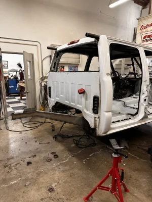

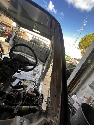

I will keep posting to get yall up to date to where the truck sits currently! We started this build the week after getting the Tamale Trolly built. This truck will be completed in January. We start MZSpec#3 next week. (No cage or any of the extras in #3) so it should be a 3 week build roughly!

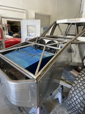

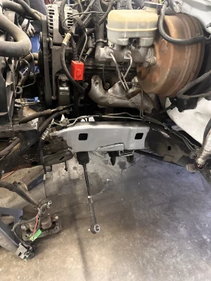

Couple Questions-
1. how are you running the TT rack with a standard mz a arm kit? Are you building some sort of rack extension for the tie rods to pivot off of?
2. how are you planning to paddle shift the TH400?
dont worry about flooding with pics. I will most def look at every one.
Your timelines blow me away more than anything...
Fortunately, ive learned from every company in the industry. Never take on work when you cant work on it. We have a few cars at a time and only take on the work load we can handle. There are 8 working hours in a day, try to be as efficient in those 8 hours as possible and keep checking things off the big ass list.
Couple Questions-

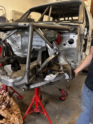

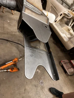

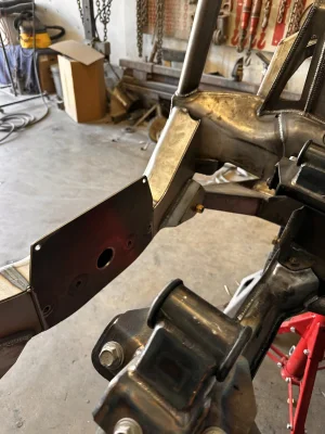

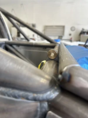

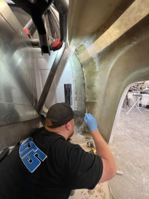

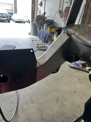

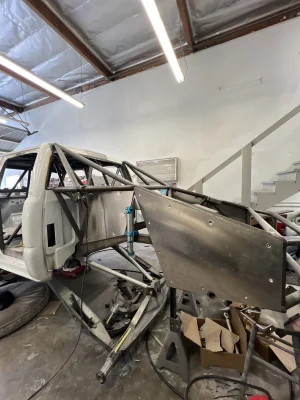

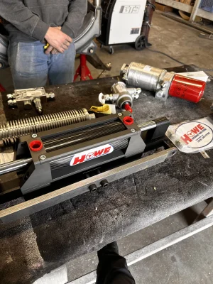

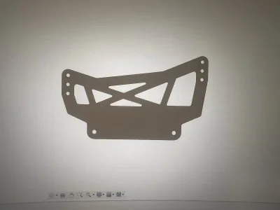

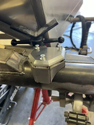

I heavily modified the front cross member and made a bulkhead to bolt the rack in.
I cad drew a steering rack adapter and 3d printed it(will be posting pictures)

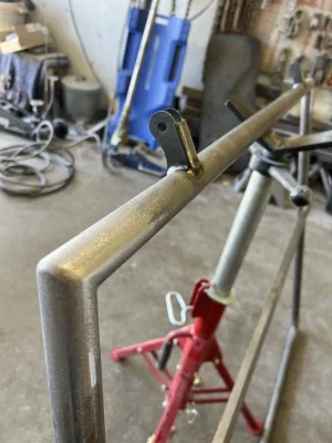

A company SHIFT makes a paddle shifter kit, i ordered one, dissected it and rebuilt it to my liking as well made my own paddle shifters that bolt to a 6 bolt momo wheel. My shifters also multifunction as a horn button on the right side and a PTT on the left side. Will also post pictures as i finish manufacturing that.

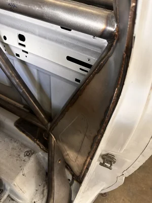

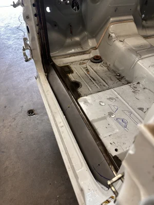

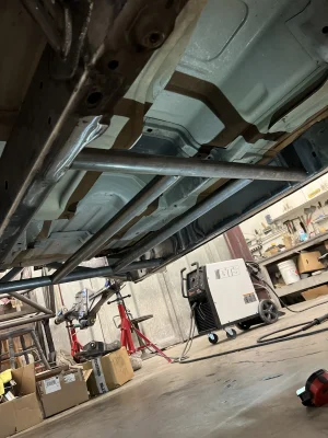

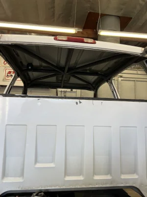

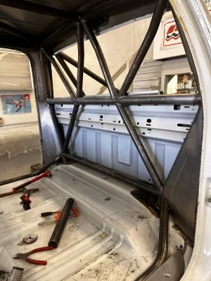

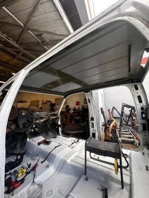

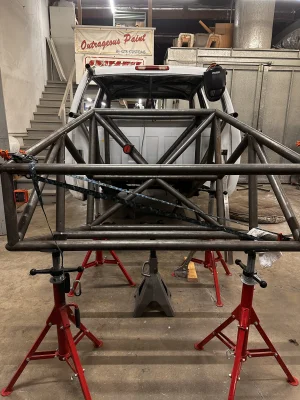

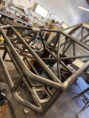

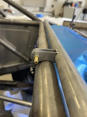

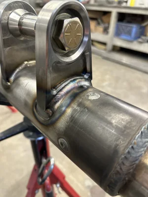

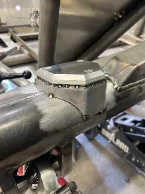

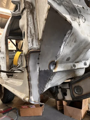

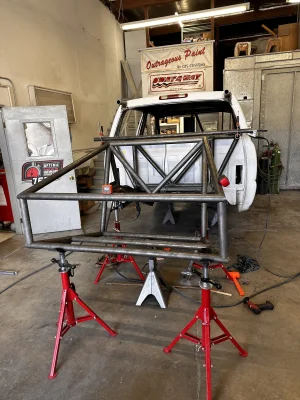

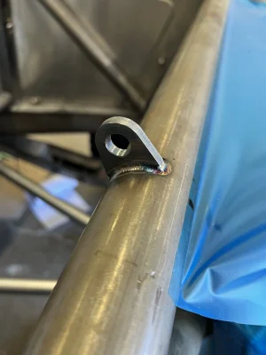

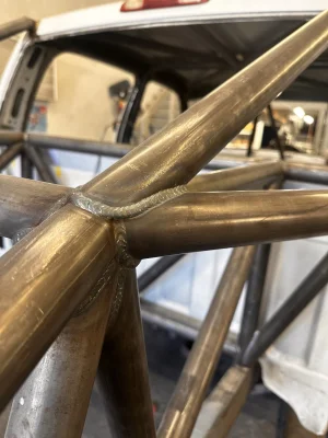

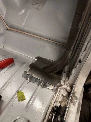

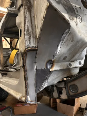

Custom bolt in sil plates

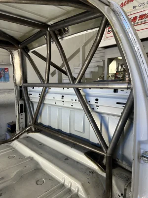

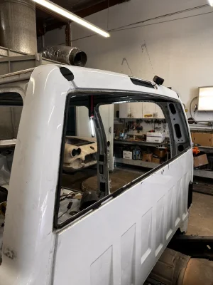

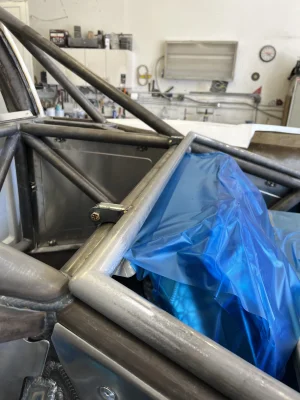

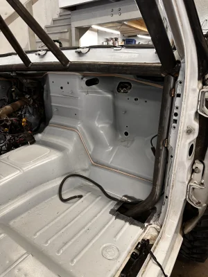

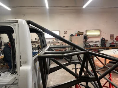

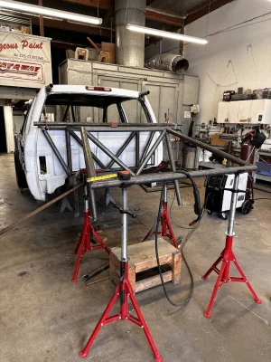

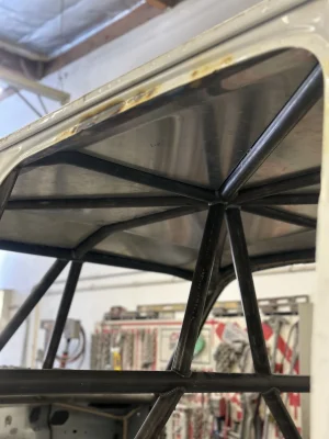

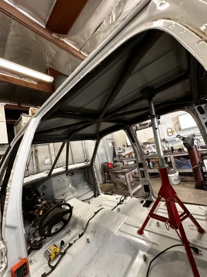

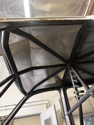

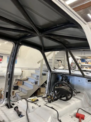

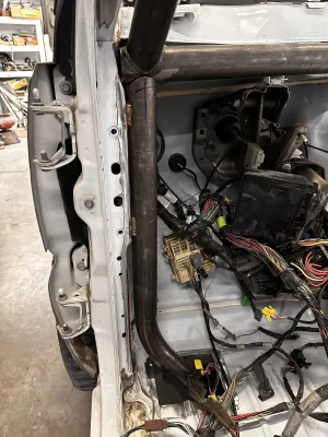

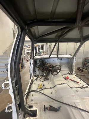

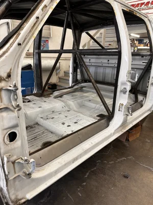

Fully enclosed cab to cage a/sily bronzed in

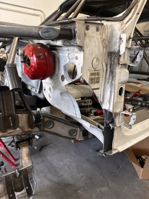

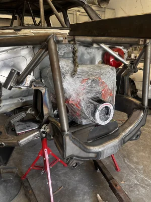

Engine cage w/ties in shock towers

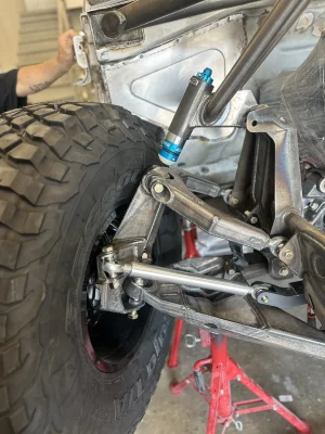

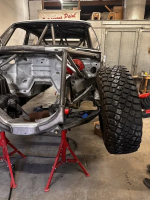

Kit at full bump/full lock for sheet metal firewall clearance
Firewall beauty panels

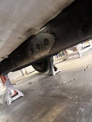

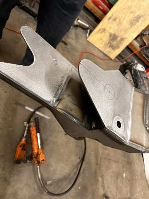

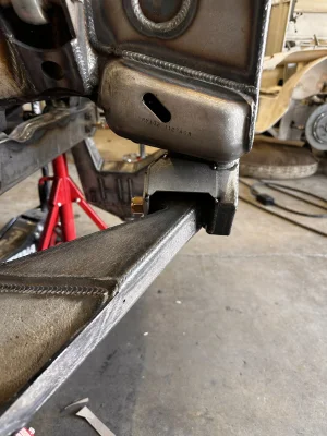

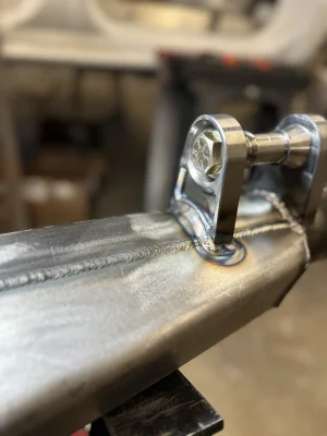

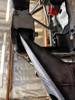

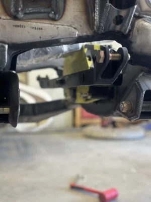

Rearend lower link mounts

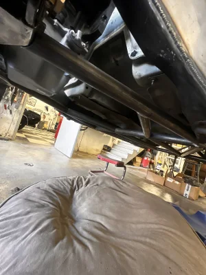

Underbelly start
Howe TT rack

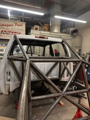

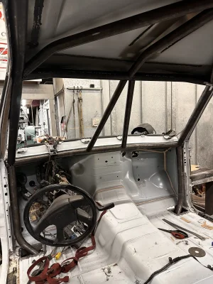

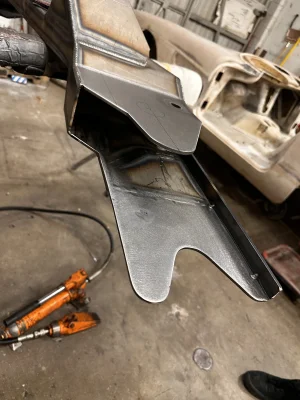

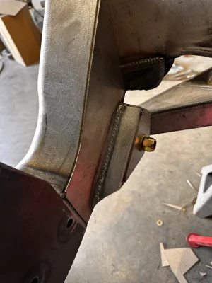

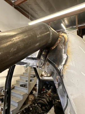

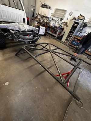

More cab to cage tie ins

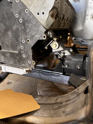

Izzy fab engine mounts/modified to push motor back 1”

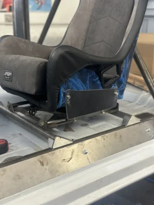

Cad design of seat mounts
Under belly tubes(more)
Prp mock up seat on a MCD1 slider (electric actuator)

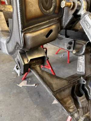

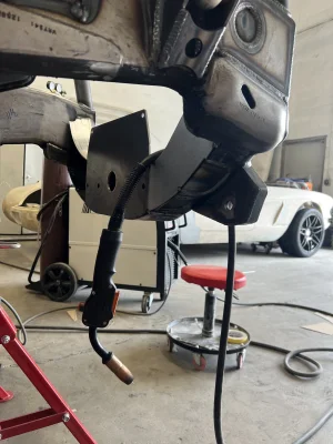

Modified crossmember for Howe TT rack bulkhead

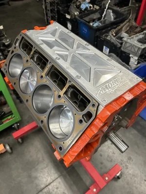

Moruzzi 575HP special
Lower control arm mounts redone with howe tt bulkhead

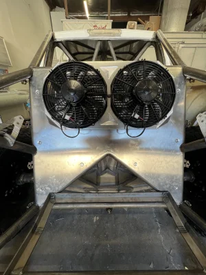

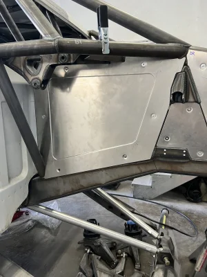

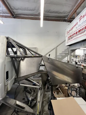

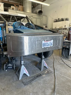

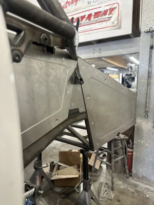

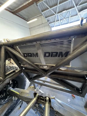

Back sheet metal panels
Sleek(no visible hardware interior headliner panels)

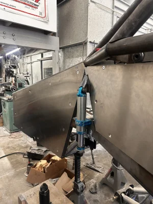

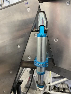

Big boy shocks showed up. (2.5/4.0 rear)
Howe Rack Adapter plate (3d printed)
DBM trans cooler
Bedside time

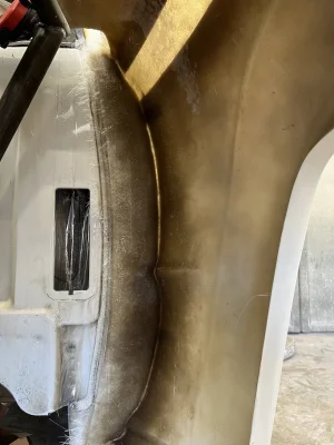

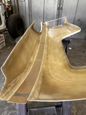

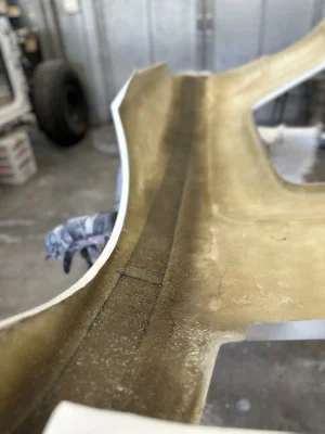

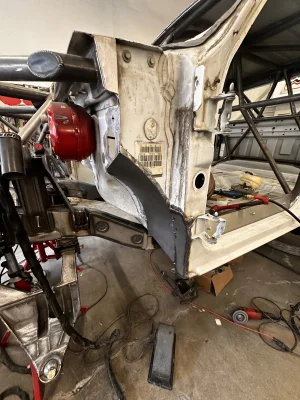

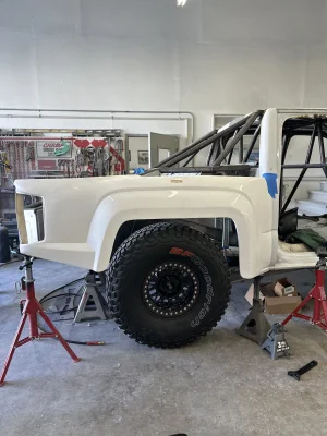

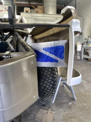

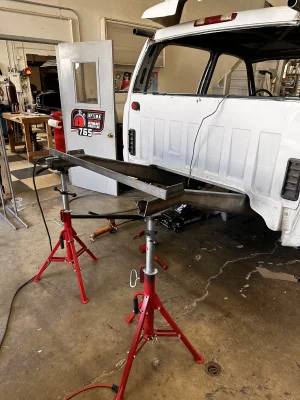

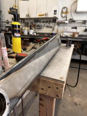

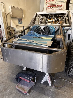

Modified the gay fiberwerx bedsides because they designed them to sit 3 inches below the back window atrocious as could be.
Also decided this truck should not have visible hardware on the bedsides, so i glassed in the bedside to match the back wall of the cab and mount directly to back wall of cab.

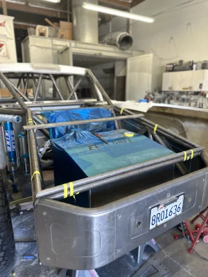

Built out the trunk for spare tires as well as a rear fuel cell hold down

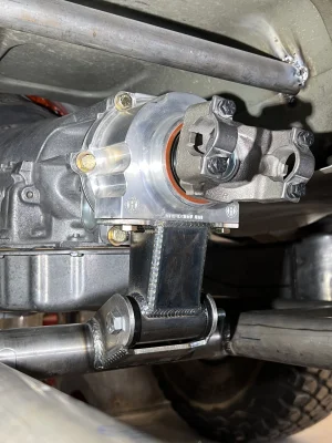

Made the trans mount for the TH400
Made some beefy bump pads with removable top plates
