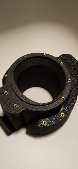

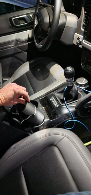

Okay why not, my wife wanted a cup holder adaptor to use her favorite Yeti.

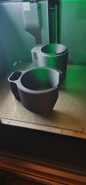

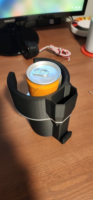

I made a few prototypes but this is the finial one...

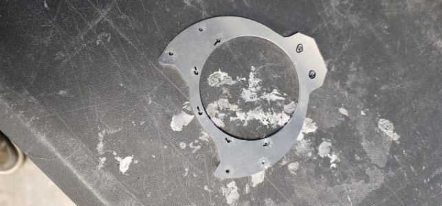

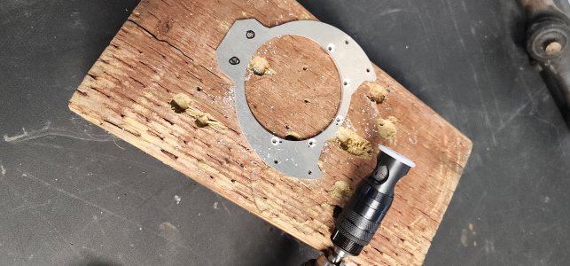

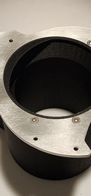

It included a center laser part from send cut send. That I did some post op counter sinking for the 4-40 screws that hold it together.

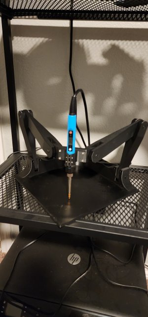

To install the plate I used some Amazon heat-serts. And this 3D printed heat insert press, which is totally unessarcy. I got the file for the press off makerlab.

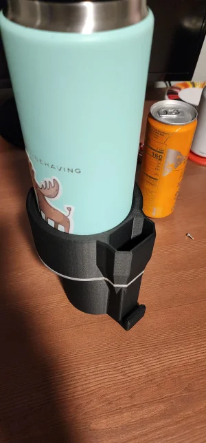

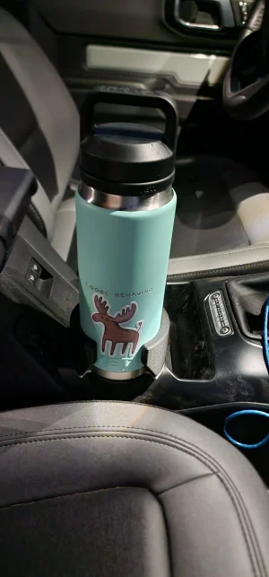

Assembled, drink check:

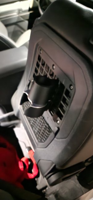

Bronco, sorry for the night shots...just took them. Ignore the dog prints...

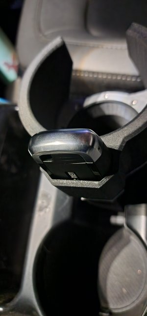

Other features, storage hook for molly seat thing and key FOB holder...
