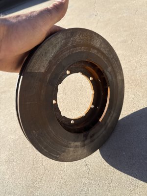

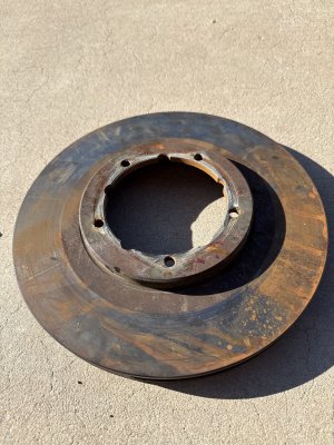

I have my rear end apart and am wanting to replace my rotors. Anyone know what these rotors are off of? I contacted Ron Schreiner and he told me that he makes them which is clearly not true. IMG_9544.jpegIMG_9545.jpeg
Makes them probably means he’s boring out that ID and putting in the lug pattern because that isn’t stock.. why can’t you just measure OD of rotor, you know your lug pattern and thickness of rotor and start searching in like wilwood or summit or someplace like that?
Yeah those are for a factory application, then he opens up the centerbore, which you can see part of the OEM bolt pattern still is there. Then they drill a new bolt pattern for his hubs.
Napaonline.com has dimensions of height and thickness to find a factory rotor that you can modify, if you have the tools or machine shop to do it. Aka buy rotors from them done for much cheaper and easier.
I know that they’re a factory rotor with the center bore machined out. I’m just wondering if anyone that is running Schreiner stuff knows what they’re from. I’ve spent too much time trying to figure out what they’re from with no luck. I called him and he said he’s out of the shop until October 7th. I was wanting to get new ones on before the expo, but it’s looking like I’ll just have to slap these back on for now and order new ones from him

Look like a machined 2005 dodge 1500 front 13" rotor
I think they measure right at 13.25"
Without a measurements from your everything is a guess tho.
^^^I thought Schreiner used Dodge rotors also. But I thought they were 11.75” diameter?
