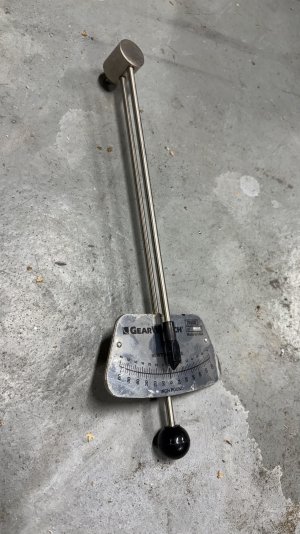

But I’m getting ahead of myself, install the pinion with old nut and an impact. Measure rotational resistance with inch pound torque wrench. Add or subtract solid spacer shim as needed to get correct rotational resistance. Measure previous crush sleeve to get a starting point. Use solid spacer shim and needed shims to get to same height as original and measure rotational resistance. You will want to use beam type not click type on both for pinion preload.
