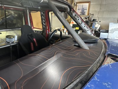

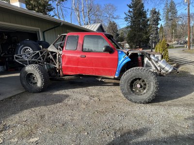

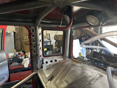

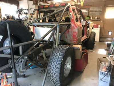

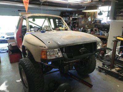

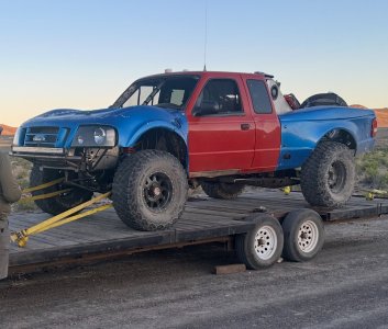

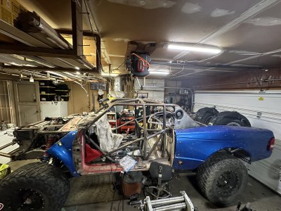

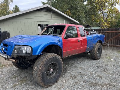

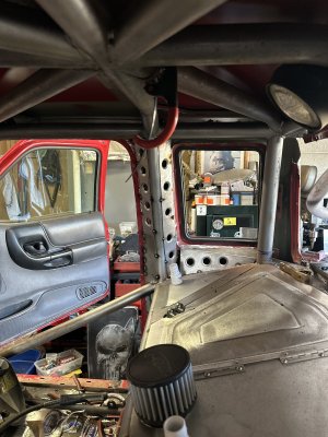

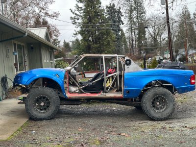

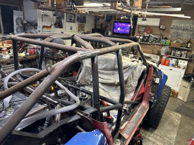

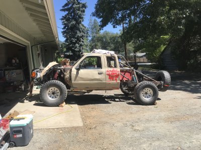

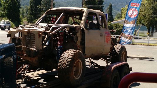

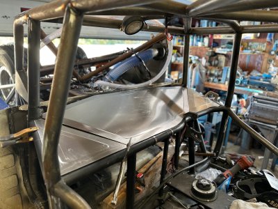

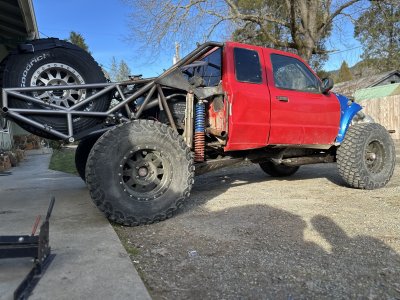

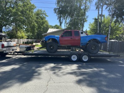

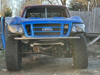

I have been around for a little bit but haven’t posted my 10 year ranger build .
Started as a short course style truck I was building for a friend in 2013 . We ended up racing my 16 car for a while and put this on hold . He passed away in 2015 and his wife gave it to me . So I sold the buggy and started to rebuild and finish this in his honor .
Long story short , I was going to race it in 7100 and then ended up changing plans a couple of times and here we are . Semi street legal steel cab working doors class 7 / 7200
4.0 mustang v6/c-4
Soon to be divorced 205 transfer case and working 4wd .
Front end Dana 44 TTB king coilover / kuster bypass
Rear 4 link fox coilover / kuster bypass
Back halted at the cab , plated and boxed frame
Motor is pushed back 7”
543 gears / 37” tires
Tuned by Juanco performance .
It’s been a love hate relationship , but now that it’s almost ready for paint , I’m happy with it .
Just need to finish building the kusters for the rear .
Hoping to be headed south for some play time around king of the hammers and maybe some VORRA races .
