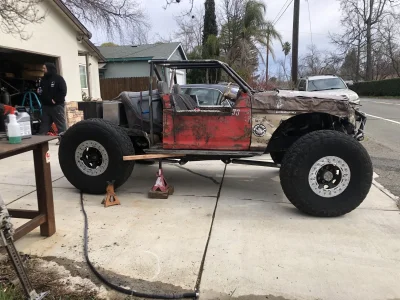

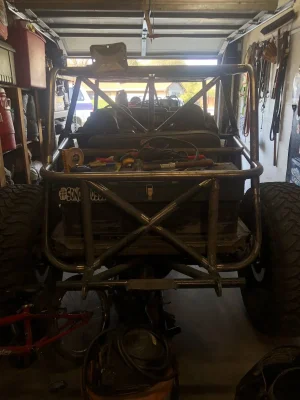

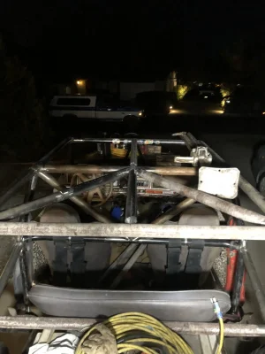

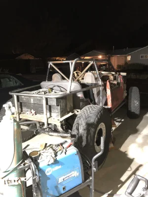

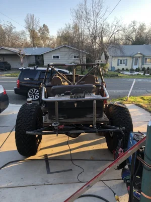

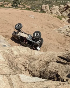

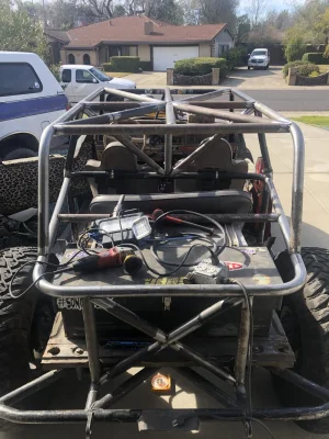

Current rebuild updates, basically gonna be a firewall buggy with skins at this point

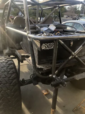

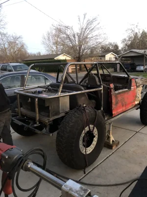

Most recent updates. Got the rear shocks in last weekend and moved on to moving front shock mounts around to lower the front to match

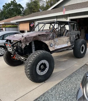

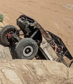

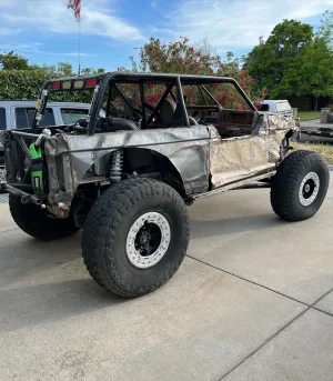

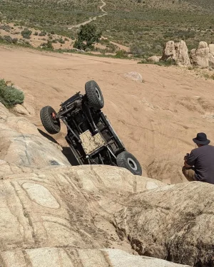

More updates now that it’s getting close to done. Managed to get it done enough to go shake it down and knock the new off it last weekend. Roof is 5” lower and belly is 1.5” lower, it works so much better now.
