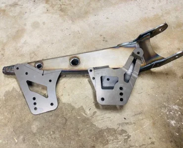

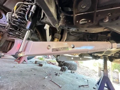

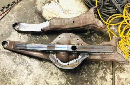

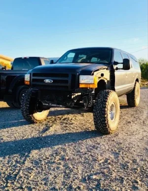

The basic kit with the stock beams, you can widen 4 inch and 6.5 inch with the holes I’ve made in those brackets
The equal length kit starts at 5 inches per side and you can go wider depending on what you want.
Both these kits only work with 99 to 07 trucks.
https://www.giantmotorsports.com/product-category/i-beam-kits/super-duty-eq-beam-kit/

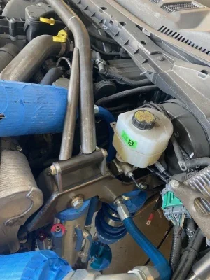

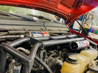

I have a bolt on Engine Cage that is not on the site.

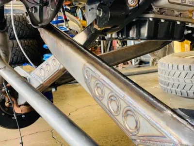

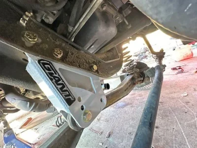

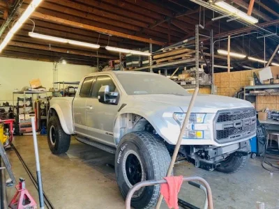

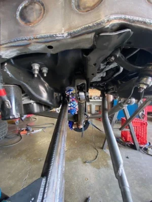

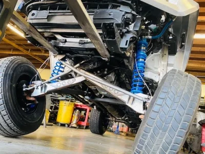

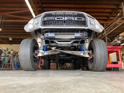

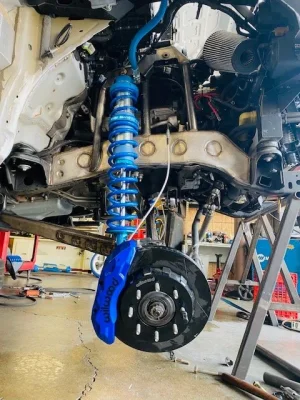

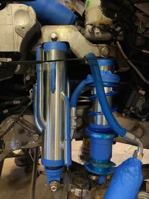

Hey Geoff, any plans to make this same thing for newer 2wd F250/F350's AlumiDuty? I have a 2019 F250 2wd and nobody makes lifts for these things.
I really wanted to make the 2020 Alumi-Duty kit, but all the time I spent on it was a waste to try and resell it because the guy wanted to run 42 inch tires with a low ride height, and once we jig up those beams and made crossover steering based off of their center steering garbage (see how I did cross over off the stock draglink). We made a set off the fixtures for another customer with a normal size tire and it sat really low and scrapped trying to offer it.
