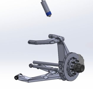

mind you, this truck is well past this stage so im going to be writing here, explaining the journey until we are up to date. the truck we started with is a 2015 f150 3.5 NO TURBO. (more products to fix that later) first things first, if we want to go fast, we need a cage. were on the fence with offering a WIY cage for these specific trucks due to the aluminum cab. i dont think this is a great platform for the garage guys. one slip up and youre ina bunch of trouble. this metal is so damn thin and cuts waaaaaaay too easy, so if you have one of these, and you want a cage, take it to a shop.

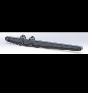

anyway back on track, i dont have many pictures of the cage process but ill explain how i did it if anyone cares just lmk. super basic cage, cut the frame off and laid out the link setup. we shortened the wheel base in the rear about 4" and used open airs WIY links to get some numbers. a shortened wheelbase crew cab either means 1 of two things: shocks are going inside the cab or shocks are going to favor the axle side and run a bigger package. being that this is a prototype truck, we had no intentions on making any products that need the shocks inside we took the numers we need and the coilover is now located where the bypass pocket is and the bypass is equal distance further back, running a 16/18 setup. our next product was born. 55" 7075 billet links running 4 uniballs and clevises. i know king makes them but we like fox so we made our own for fox shocks. our links are for short wheel base trucks that dont want the shocks inside the cab. we also programmed our cnc so if you want to change the shock location we can offer custom layouts for roughly $300. they also come witha 4130 skidplate. pretty stoked but as of right now we are still running the open airs as we put money towards other parts of the company. ill attach our drawing below.

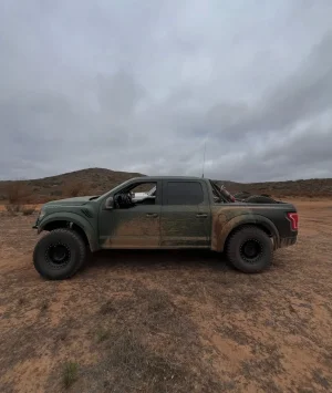

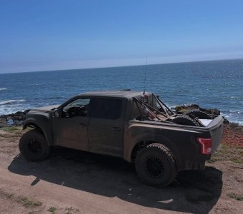

so now we have a caged truck, links setup and we decide to toss the tailgate on as well just so we can blend in a tad on the street. we get a little excited with the 500 coming up so we slap a wrap on, grab a starmount and load it up on the trailer and send it mexico untested and tired. got a last minute spot at estero beach resort, unloaded, did a quick nut and bolt check and hit the trails. had a great time no problems other than a brake line.

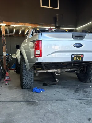

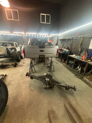

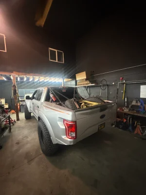

had a little time last week to toss in the new housing. the old one was an oem super 8.8 oem gears and open diff. we have been developing a truss kit that you can 4 link your truck while keeping the oem housing, i put it together with 5:13 gears and an e locker and finally had some time to put it in. i could run the oem brakes but i ordered some superlight 4 piston wilwoods instead because why not

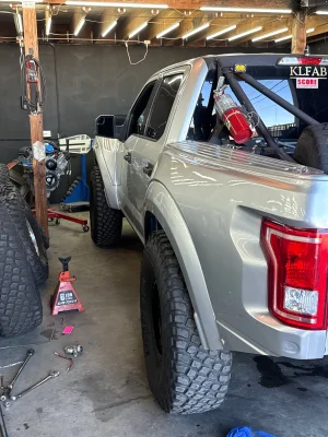

ah i left out a couple steps haha, i got it painted factory silver and threw on some 40s as well. next up i have to clearance the spare tires for 40s as well while keeping the tailgate, might happen, might cut it all off, i guess we will see
